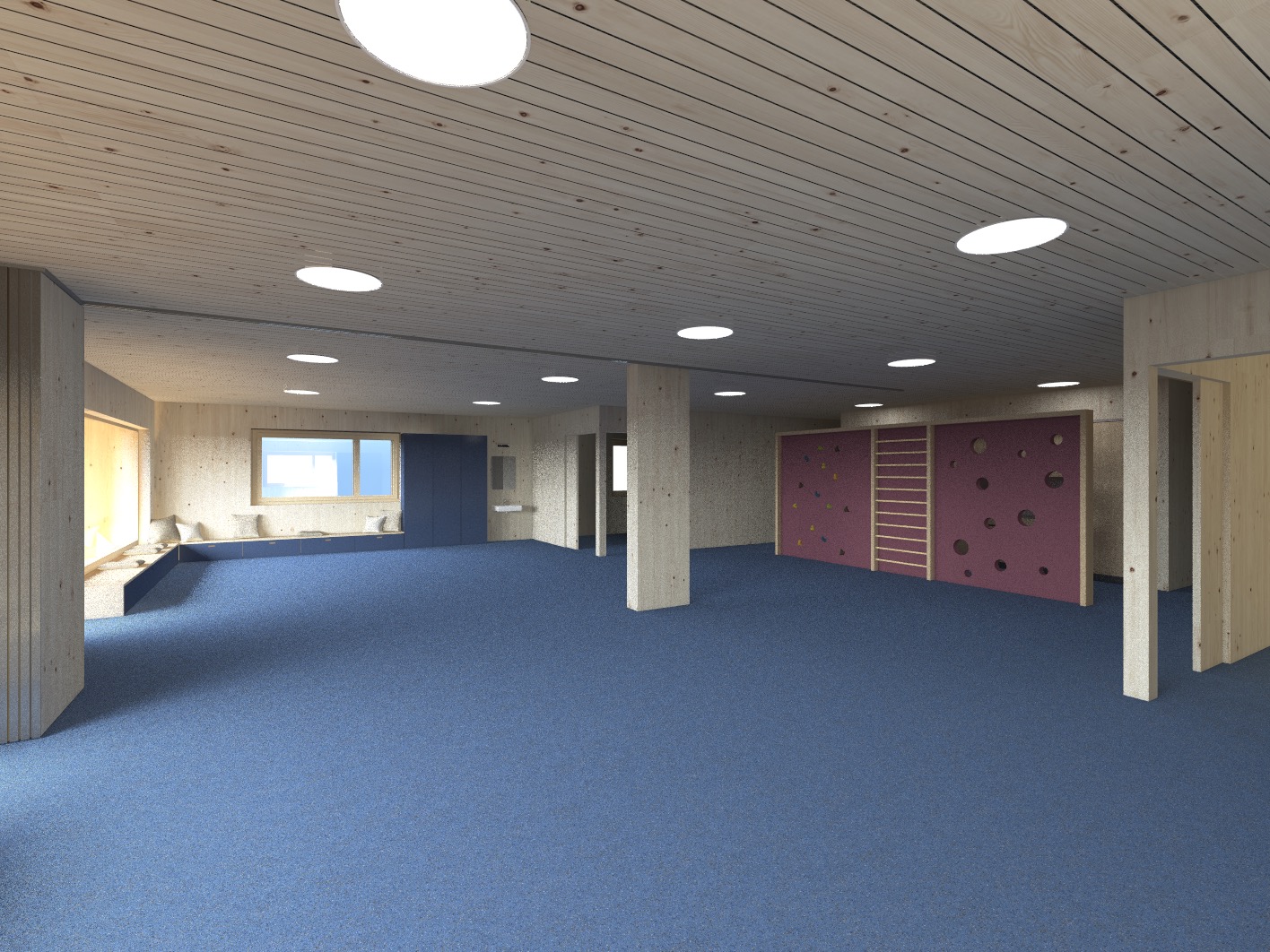

i have an interior 2835 × 2126, no lights, only the neon shader. At the first try it needed about 1 hours 30. Then I changed something to the model and now it needed about 8-9 hours. What could be the problem?
in the att the first image. I have only changed the shade of the ceiling lamp (round)…

I made a lot of test with your file !
The conclusion is that using Neon shader on a complex object like your ceiling lamps combined with the Enhanced Background setting checked is taking a lot of time.
The square ceiling lamp has a lot less triangles, hence taking less time to render.
I have created a Round ceiling lamp using the neon shader only on the bottom circle and the rendering time went from 1h6mn to 23mn, with the same rendering settings !
I turned off some of the shader reflexion to make sure the time difference were not coming from the reflexion and roughness calculations.
